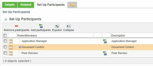

I have code to make sure that Roles are filled in before Completing a task.  What I am trying to do is to check multiple roles as being required or not based on workflow variables.  Does anyone have the code for this?
Example (The first two variables are an if this or this):
If varible1=outcome1{
Then Role1 must be filled in
if variable2=outcome2{
if  variable3=outcome3{
Then Role2 must be filled in

That actually helps for a different piece of the puzzle that I was going to be getting to.  The problem I am having is that I have a step where a user defines the participants for Roles 1-3.  I know how to force it to fail if any of the Roles are blank.  What I am trying to do is only error out if ones are blank based on certain attributes.  So in the example below, either all three would need to be filled out or just one would based on choices when creating the workflow.
