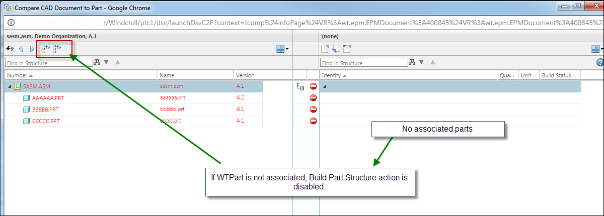

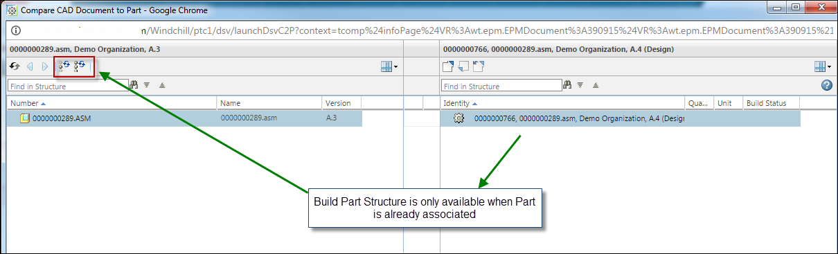

I found that Build Part Structure is only available when Part is already associated. Similarly if WTPart is not associated the action is disabled. Find below:
By selecting this action it will rebuild structure (WTPart iterated). So what I think is you have to first create associated Part to EPMDocument and then you can build structure above screen capture dictates. Refer to https://support.ptc.com/appserver/cs/view/solution.jsp?n=CS182312
I hope this helps you!
