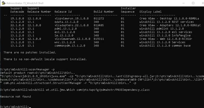

com.ptc.wpcfg.pdmabstr in Windchill 13.1.2.0
I am using Windchill PDMLink Release 13.1 and Datecode with CPS 13.1.2.0
During an update from Windchill 12.0 to Windchill 13.1.2 I had an issue with compiling a java file.
import com.ptc.wpcfg.pdmabstr.PROEDependency; is used in the file but it's not recognised by Eclips.
The class should be availeble in DDLBasic.jar. Is it moved or deleted (com.ptc.wpcfg.pdmabstr)? Do I neet to use something different?
I have a workaround, the variable is used once and should be a constant value, but that is not a clean solution.

    can you run below command on the 12 and 13 system
    windchill wt.util.jmx.Which com/ptc/wpcfg/pdmabstr/PROEDependency.class

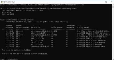

    On the new server Windchill 12.1 and 13.2 is installed.
    I tryed your action in the Windchill shell for both versions.
    At windchill 12.1 the resource is found:
    At Windchill 13 the resource is not found:
