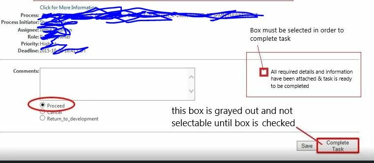

Hi all,
I have to create a check box in the change activity with string type and until the check box is ticked the complete task button should be disabled. please find the attached image for reference.
can anyone please provide a solution for this?

You can add an WF variable and check if the variable is set to true in the complete task transaction.
The user will be informed that something is wrong.
if you need to return error message in the task completion  transition use following code
String msg = "Can not complate the task without checking the check box";
java.lang.Exception exp = new java.lang.Exception(msg);
throw exp;
Complete Task Transition
Error Handling in Transitions
here is an example with required task comment
CS152927 - How to validate that the "Comments" field is not empty
you can use this alternative technique for your parameter
PetrH

hi,
thanks for the solution,
for creating wf variable here, should it be boolean variable or string variable? and in the display name i need that sentence which i had attached in the image, can you please tell me how to get that?
Ak

Hi @AK_10813265
Test it. If you use string, how do you think it would be displayed? As a input field i guess.
Try to use boolean.
Try to put the sentence to the display name of the attribute.
maybe there could be different way how to put there so long text.
