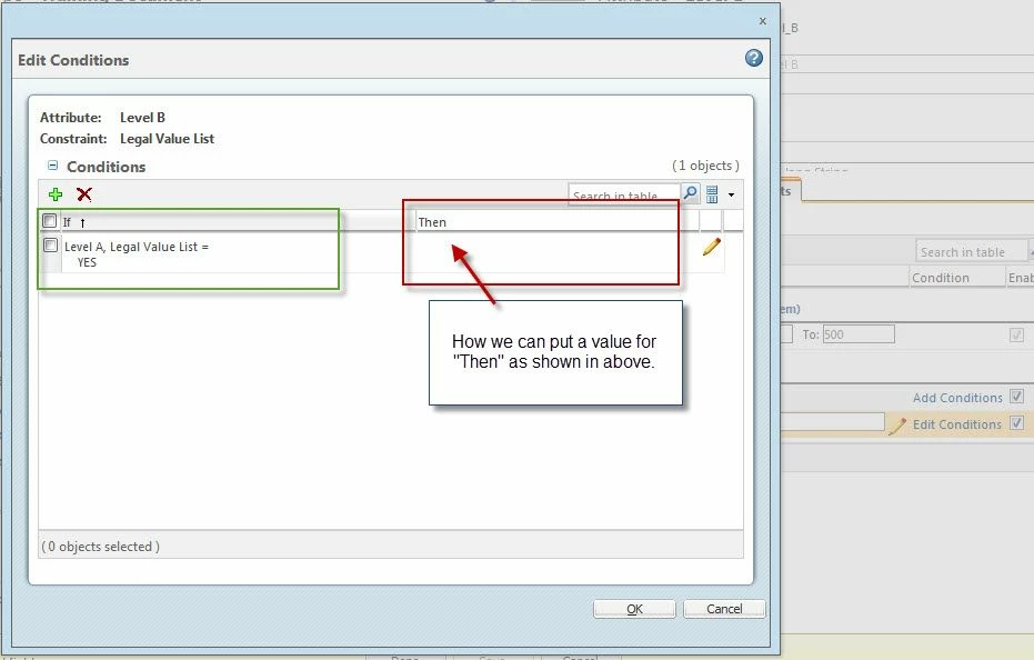

Hi All,
Here is my requirement,
I have 2 Attributes on Document, i.e. Level A and Level B. level A is Boolean type attribute and Level B is String type.
we need a behavior like, when Level A is true then Level B must be mandatory attribute and if Level A is false then Level B is normal attribute or grayed out attribute.
while doing this i am exploring "Conditional Constraints" in type and attribute manager, where we can choose a Driver attribute on that basis it will render driven attribute, but my difficulty is that in this case, i am able to select Driver attribute, but not able to set behavior of driven attribute.
Please check attached Image. and let me know how i can save information

Hi @vuchekar,
If this is 10.2 or earlier then this can be achieved using JavaScript call in Data Utility.
May be you can refer to: https://community.ptc.com/t5/Windchill-Questions/Dynamic-Drop-down-list-in-Windchill/m-p/541597
Similar to:
comboBox.addJsAction("onChange", "<yourJSAction(this)");
Shirish
