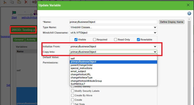

In Windchill, I am creating an automatic promotion request at the end of the change review process with the following code. However, I have two questions that I couldn't resolve.
  1. Question: I have defined a boolean variable "Should automatic promotion request be initiated?" within the activity at the approval stage for the automatic promotion request code. I want the code below to execute if this variable is true; otherwise, it should not execute. How can I achieve this?
  2. Question: I want the person in the submitter role who initiated the change review process to be assigned as the "created by" for the promotion request. These questions might be simple, but I haven't been able to find a solution.

Jul 19, 2024 11:42 AM UTC
@Emrec@n
For the creator, I would try to use setPrincipal with the name of user that should be used
usually you get session principal store it as a original user variable
then change the session to user who should save the object
save the object
set the session user back to original user.
// get the session user
wt.session.SessionHelper.manager.getPrincipal();
// set the session user
wt.session.SessionHelper.manager.setPrincipal("userName");

Jul 19, 2024 11:19 AM UTC
Hi @Emrec@n
1. You can use the variable in the condition and based on that value go to a right way in the workflow path
usually copy the variable from user task to global variable in the workflow. it is ootb function.
2. I guess that the method assignIterationCreator can not be used to the object that is not versioned. Promotion Request does not have revisions and iterations..

Emrec@n8-GravelAuthor
8-Gravel
Jul 19, 2024 11:33 AM UTC
@HelesicPetr
Thank you very much for your guidance. How can I copy the selected value within the Activity to a global variable? Do you have a ready method for this? Finally, what method can I use to assign the user to the promotion notice? Do you have any suggestions?🙏🙏🙏
HelesicPetr
Jul 19, 2024 11:34 AM UTC
Hi @Emrec@n
It is OOTB function in the workflow, that does not need any coding.
PetrH
