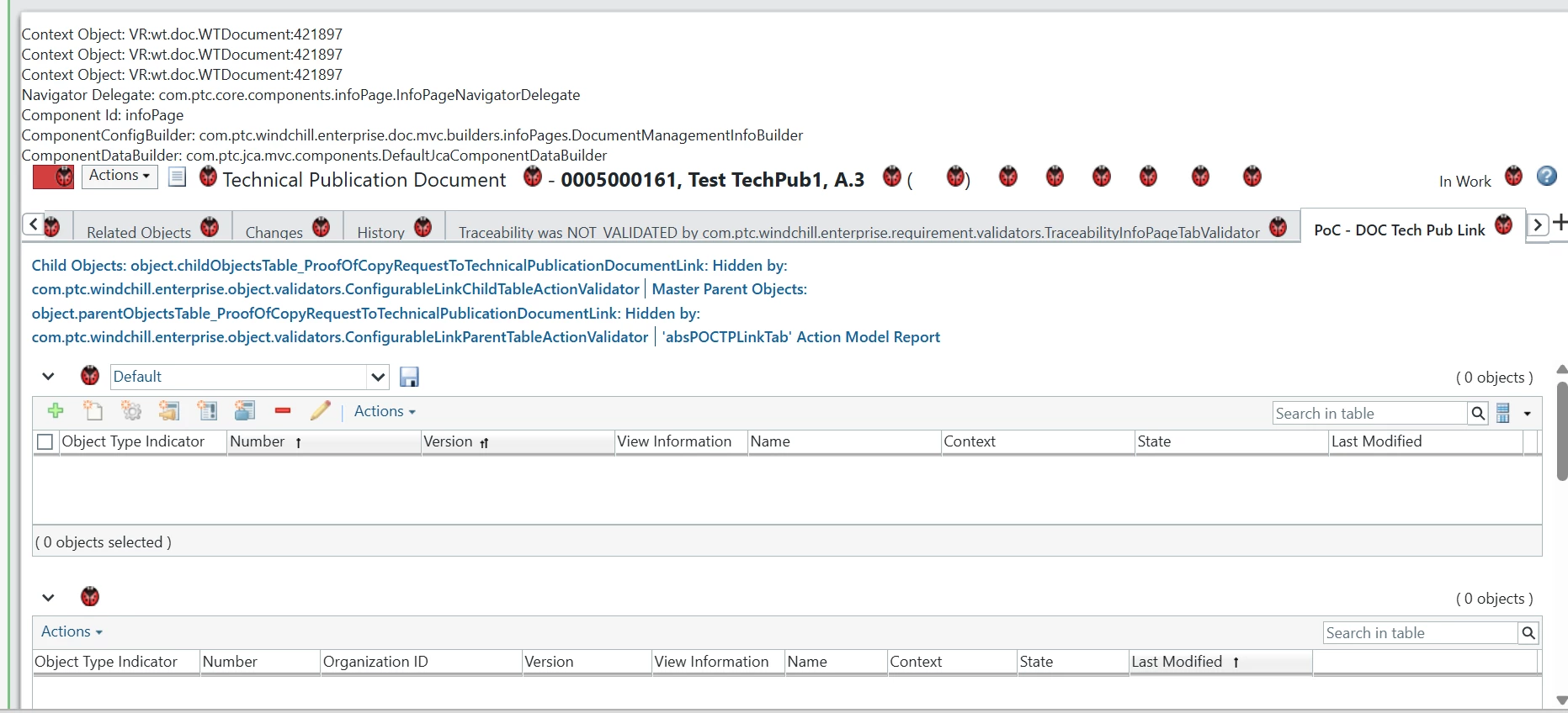

Please enable jcaDebug and share screenshots showing the missing tab.

I have attached screenshot
belo

Sep 17, 2026 5:36 AM UTC
Hi ​@TDT  Thank you!
I will update
Sep 17, 2026 11:05 AM UTC
Hi ​@TDT
I have uploaded and compiled the changes, but I am still unable to see the tab in the child object.
