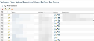

In our environment we have had multiple issues with users accidentally deleting a Workspace which contains changed (not checked out) and new objects by miss clicking upon activating a workspace.
The Delete button is right next to the Activate button and both require an extra answer in a pop-up window:
When Activating you must answer this question:
And when Deleting you must answer this question:
If your mindset is to activate the WS and you know you get the extra question to which you must answer YES, you are very likely to click on the OK button when you accidentally clicked on the Delete button.
In other posts people have asked about recovering removed workspaces, but unless you have uploaded all your new and changed files, there is no way to restore these files. They are really gone.
So now my question:
Is there a way to customize the My Workspace view and remove the Delete function from  the Actions menu?

Thanks for the reply, but not really what I was looking for. Users should still be able to delete their workspaces.
It should only be a bit more difficult and not right next to the activate button.

I think I found a solution.
I was able to hide the delete buttons with a CSS definition.
All delete buttons have a HTML property named trlid. The value of the property is set to "ExtWorkspacesTable_ws_<name of the workspace>_ws_activate_action".
Now, You can simply create a CSS file on Your server, that is accessible from Your Windchill page ( I look at You, CORS - Error 🙂 ).
/* special selector, see https://www.w3schools.com/css/css_attribute_selectors.asp */
a[trlid$="_delete_ws_action"] {
 display: none;
On Your Windchill installation look for the file codebase\templates\uwgm\cadx\workspaces\ExtWorkspacesBody.html
Edit the HTML file an insert link to Your created css file:
<!-- The My Workspaces body is simply the workspaces table subtemplate -->
<link href="https://<your server>/<path to your CSS>/no-more-delete-buttons-beside-activate-buttons.css" rel="stylesheet" TYPE="text/css"/>
<script language=Windchill>
 processSubTemplate action=ExtWorkspacesTable
</script>
