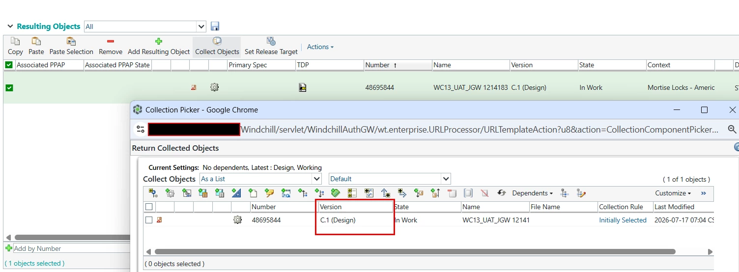

This is for Revision, I am able to customize that but not version. I’m unable to figure out which OOTB class is used for diaplaying version here.

Thank you for the response, but I’m not looking to add or remove a column from the view. I want to control what is being displayed in the Version column, I need to add a business logic to the OOTB class that’s controlling the version.

The collector table is hardcoded and standard dataUtilities are not used in this table. It is JSDataUtility
I identified just that the column version is internally called “iterations” and I could just identify a view that is used.
com.ptc.windchill.enterprise.change2.tableViews.CollectResultingObjectsJSTableViews

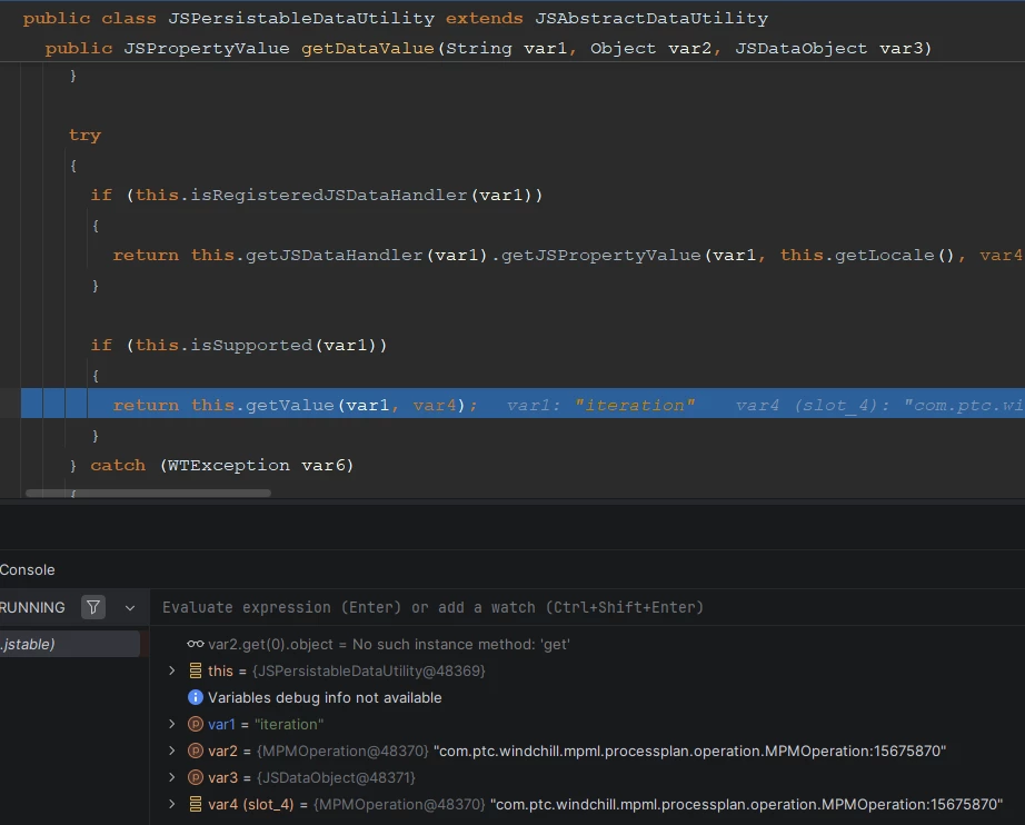

It took time :D
I’ve found the DataUtility that is used but it is not standard.
com.ptc.core.htmlcomp.jstable.JSPersistableDataUtility
Data utility process all the attributes in the table so you have to catch the right column ID and process as you need. The version id is “iteration”
