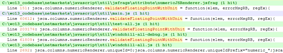

I started poking in to see how this could be done. I noticed that attributes with real numbers with units have a JS validation script associated onBlur. The function is "jsca.columns.numericRenderer.validateFloatingPointWithUnit" but surprisingly, this function is defined in 5 different locations in the codebase. Not sure which one is the one called when the attribute entry is validated but it should not be too hard to narrow that down.

My thought would be to hook in another JS call before all this to transform the input if it encounted a "/" character in that first part, converting it to a decimal. What do you think? I can call it only if it detects a "/" otherwise pass through. Still strange there is 5 copies of this function floating around...
