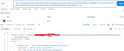

Count number of element returned by OData request
My count OData request does not work :
https://<url>/Windchill/servlet/odata/v5/DataAdmin/Containers('OR:wt.pdmlink.PDMLinkProduct:681234555')/Folders('OR:wt.folder.Cabinet:681234597')/Folders('OR:wt.folder.SubFolder:681267970')/Folders('OR:wt.folder.SubFolder:681267975')/FolderContents?$count
Thanks for any help.
Fred
Version: Windchill 12.1 (Product v12.1.2.0, REST Services v2.3)

Hello @Fadel
Thanks for your message. I don't think I have duplicated values, but I have so many values that I get this mesasge. So I would like to paginate the results using 'count', 'top' and 'skip' parameters but it doesn't work and I wonder if it is because of the version I use.

In your request URL I observed the Boolean value missing for $count, there is no issue with the version
https://<url>/Windchill/servlet/odata/v5/DataAdmin/Containers('OR:wt.pdmlink.PDMLinkProduct:681234555')/Folders('OR:wt.folder.Cabinet:681234597')/Folders('OR:wt.folder.SubFolder:681267970')/Folders('OR:wt.folder.SubFolder:681267975')/FolderContents?$count=true

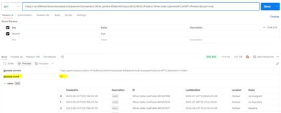

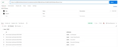

I've modified the request as you proposed : "$count=true", but server seems to request first all elements before to count and I get always the same error message 😞 : "The returned query result has exceeded the query limit, and only 50,000 result returned."
6-Contributor
Aug 18, 2025 1:29 PM UTC
Sorry, I was confusing with the rest request. My apologise.
With ODATA request it works fine, Thanks a lot !
