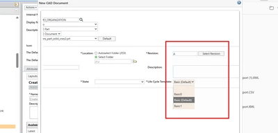

I have 5 states, design, development, production gate, production change and production released.
When a user create a new CAD document it starts in design and has to go through the production gate to reach production released.
The production gate is intended for CAD moving from development prototypes to production and requires extra approvals. But there are times when production engineers need to create a part which do not have to go through the production gate approvals. Is there a way allow them to create a part in the production change state? I see in the ACL that there are permissions for create in the specified state but I'm not sure how to set the life cycle state before creating and checking in a new part.
