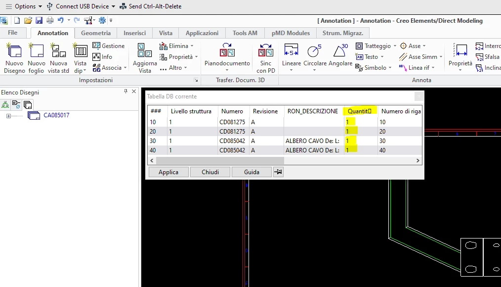

I am trying to insert a Bom table from WGM Windchill into Creo Elements Direct Modeling.

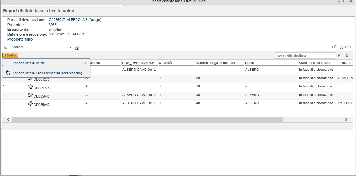

From Wtpart Structure I generate the report and export to Creo Elements Direct Modeling (see photo 1).
In Creo Elements Direct Modeling I see the table generated by Windchill (see photo 2)
The word Quantity is written with a special character instead of à with an accent. It seems that in the Italian localization that character is not recognized.

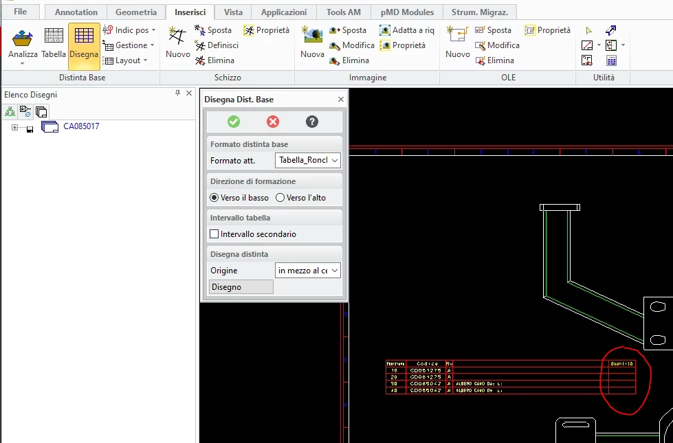

This means that the value of the quantity itself is not displayed in the table. (see photo 3).
If, on the other hand, I do all the same process with WGM Windchill and Creo Elements Direct Modeling in English, everything works because the word Quantity has no accents and is recognized.
What could I also do at the operating system level to make it work in Italian too?
