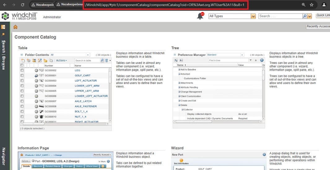

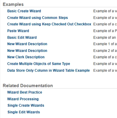

Do we have any sample jsp code for attributes and values page @HelesicPetr
HelesicPetr
Apr 28, 2025 9:29 AM UTC
Hi @SK_12337814
A Windchill Catalog contains many examples
http://secureInformation.com/Windchill/app/#ptc1/componentCatalog/componentCatalog?oid=OR%3Awt.org.WTUser%3A11&u8=1
