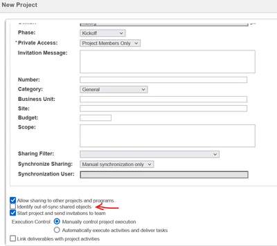

"Create project" - "Identify out-of-sync shared objects" checkbox

Is there any 'acceptable way' to customize the "new Project" wizard to make this "Identify out-of-sync shared objects" be enabled by default?
I know there is a way to do it through file "showCheckBoxes.jspf" but I'm pretty sure that modifying JSPF file is not acceptable. I can't find any other way, and seems there are no preferences for modifying this.

Hi @m_walendziuk
What do you mean not acceptable? Windchill+ ??
If there is not an another way how do you want to do so?
The wizard is build by JSP file so you need to change that file.
I also haven't found better option to customize it.
PTC should be more opened with Windchill+ customization....

Hi @m_walendziuk
PetrH
September 27, 2023
Hello @HelesicPetr  yea, I had Windchill+ in my mind. And I simply asked because I was wondering if such checkbox could be controlled over some property or preference - maybe I haven't searched good enough and thus asked question here.
Agree, Windchill+ with all these constraints makes really limited to make actual use of Windchill in some instances.
Then I guess there's nothing more to do here, thanks for your feedback.
