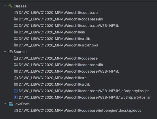

    You have to add the library from the Windchill installation to your IDE
    here is example of my configuration in inteliJIdea
    PS:: I don't have Windchill installation on my IDE client. I have just a copy of the needed libraries from the Windchill structure of the correct version.
