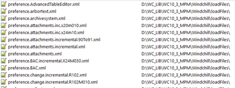

HelesicPetr
Sep 30, 2024 7:12 AM UTC
Hi @rhart
If you try to search a csvPref definition in all files in the Windchill folder, you could find what you are looking for.

rhart16-PearlAuthor
Sep 30, 2024 9:36 AM UTC
Thanks @HelesicPetr  I found it in there, it's called com.ptc.windchill.enterprise.preference.handler.NumberPreferenceValueHandler:1
I was searching Integer
HelesicPetr
Sep 30, 2024 10:09 AM UTC
Hi @rhart
I used "csvPreferenceDefinition" as a search key word ::D
