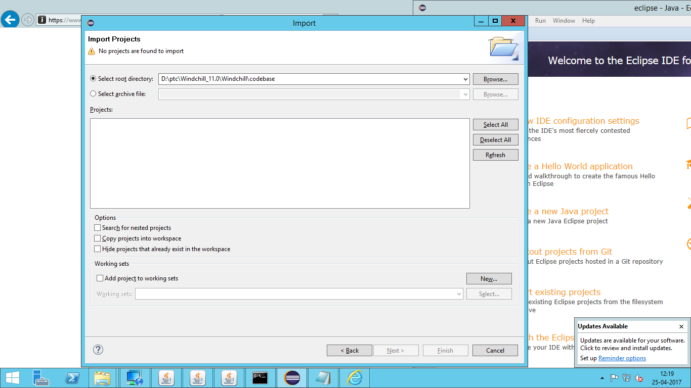

     I did not find the example in eclipse please help me to find
Import the cust_Windchill_src project
   a) File -> Import... -> General -> Existing Projects into Workspa
   b) Select Browse (next to "Select root directory") and click OK
   c) Your project will be listed and checked; click Finish.

Eclipse's import project can only import a project created by eclipse.
You should have 2 sub-folders,  .project and .classpath.
If you only have the java sources, you need to create a new project with existing sources.
You'll have to handle all the PDMLink dependencies.

The "OP" was remarking that the Eclipse Project "cust_Windchill_ src" described in the Windchill Customization Guide (e.g. 11_F000_WindchillCustomizationGuide.pdf) is not located where the text of the guide indicates. The OP and I are wondering where the existing Project can be found. An OS-level "find" of the Windchill installation folders finds no matching .project files, none at all.

followed the video but dont see source files.  i got this error when i run the command in linux.  do you have the example project that we can download and use?
]% ant -f bin/tools.x ml eclipse_project

Hi @HV_10416589
What source file do you expect?
Usually developer crates own source files.
Windchill source(java) files are not copied to the destination of eclipse project..
Also I do not recommend to use the src(java) files from Windchill folder because they are not very often up-to-date.
