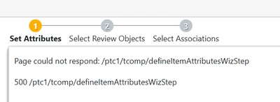

Custom action trigger gives 500 error
Version: Windchill 13.0
Use Case: I'm trying to replicate functionality for custom actions triggering a particular workflow. In my case, it's a peer review workflow. Following the customization guide I get almost to the end and then get a /ptc1/tcomp/defineItemAttributesWizStep error.

So that's all well and good. On server restart, my custom action with correct text and gif shows up in the right-click menu and folder actions for WTParts.
When I click it, though, there is an error.
In the method server logs it says that:
com.ptc.jca.error <my user name is here> - Cannot read the array length because "<parameter1>" is null jakarta.
I also referenced this absolute gem: Triggering a workflow from custom actions.
In my case, I'm trying to have my Peer Review object just start as is with my workflow. There isn't a custom workflow bit of code for ECNs... but that specific workflow is explicitly called out in preferences for the context whereas the review workflow isn't.
The defineItemAttributesWizStep works just fine for other calls. So something somewhere is missing and I don't know where to go look.

Solution found!
At the beginning of the JSP the subtype needs to be fully defined:
<jca:initializeItem operation="${createBean.create}" baseTypeName="wt.change2.WTChangeReview|wt.change2.PeerReview|com.xxx.www.reviewObject"
 attributePopulatorClass="com.ptc.windchill.enterprise.change2.forms.populators.FlexibleChangeReviewAttributePopulator"/>
I had this be just the soft type without the full path and PTC was able to replicate this.
