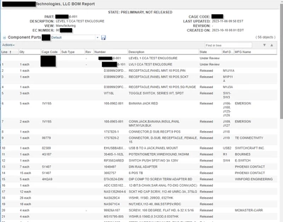

This is the closest we came to your description. Its not PDF but normal Windchill page that the user can print to PDF. It still has some issues I am trying to work out, mainly WYSIWYG stuff where the column widths get funny when printed. It has a header and footer and is triggered from an action added to Reports on the Structure tab of a Part. Lots of unknowns in your description. Single or Multilevel? Are you applying any default config spec or filter?  Personally, I consider anything PDF to be for humans only and throw away. Its a nice to have but not true source once printed.  The major trick with this report was getting the BOM table to display fully, no matter how long it was. Windchill tables have a viewing window and a scrollbar so when printed, you only get what is in that window.
