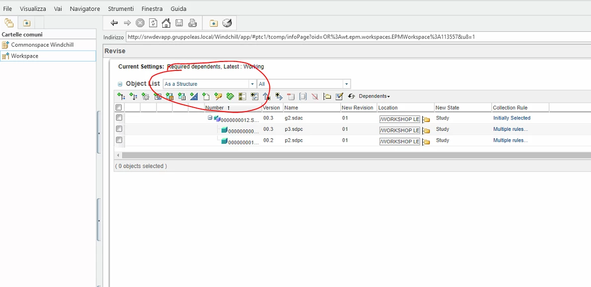

Is it possible to have a view in the workspace that displays the objects as a structure?
Basically with the same options I have in the sava interface with name, rename or change state.
(see attach)
Matteo.

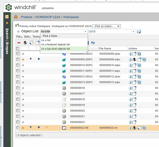

Hi @Matteo_1987
Unfortunately the answer is no.
If the option is not in the view list it is not possible.
Check previous answered question View-assembly-structure-in-workspace
Also an idea has been closed as no plan to implement. The Idea View-workspace-as-a-structure
You still can create new idea.
