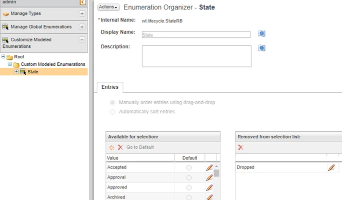

Hi all,
Looking at customizing lifecycle states in a sandbox, adding my own states, I should have access to a "Customize Modeled Enumerations panel" under Site - Utilities - Type and Attribute Management. However, I only see the usual five "Manage,,," panels.
Guides tell me not to do this directly in files, but use the utility.
I'm trying to find out what I'm missing, but no luck so far in PTC help pages here. Can someone point me in the right direction, please?

Hi @Zoltán
What Windchill version do you use? this is available on 12.1 +
In the older versions you need to use windchill shell enumcustomize utility

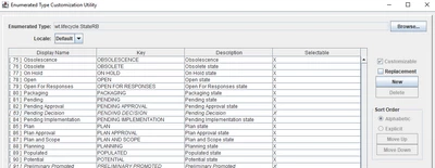

Answering myself, probably via Windchill Shell.... but I don't get the guide in the Help Center then.
  1. Open Windchill shell.
  2. Type enumCustomize. Hit Enter.
  3. Enumerated Type Customization Utility will open.
  4. Browse to <Windchill>\codebase\wt\lifecycle\StateRB.RB.ser and open it

Aahh, and here I am playing with marbles on 12.0.2.10, looking at the guide for 12.1.2.0.
So it's a new thing then. Gotcha.
