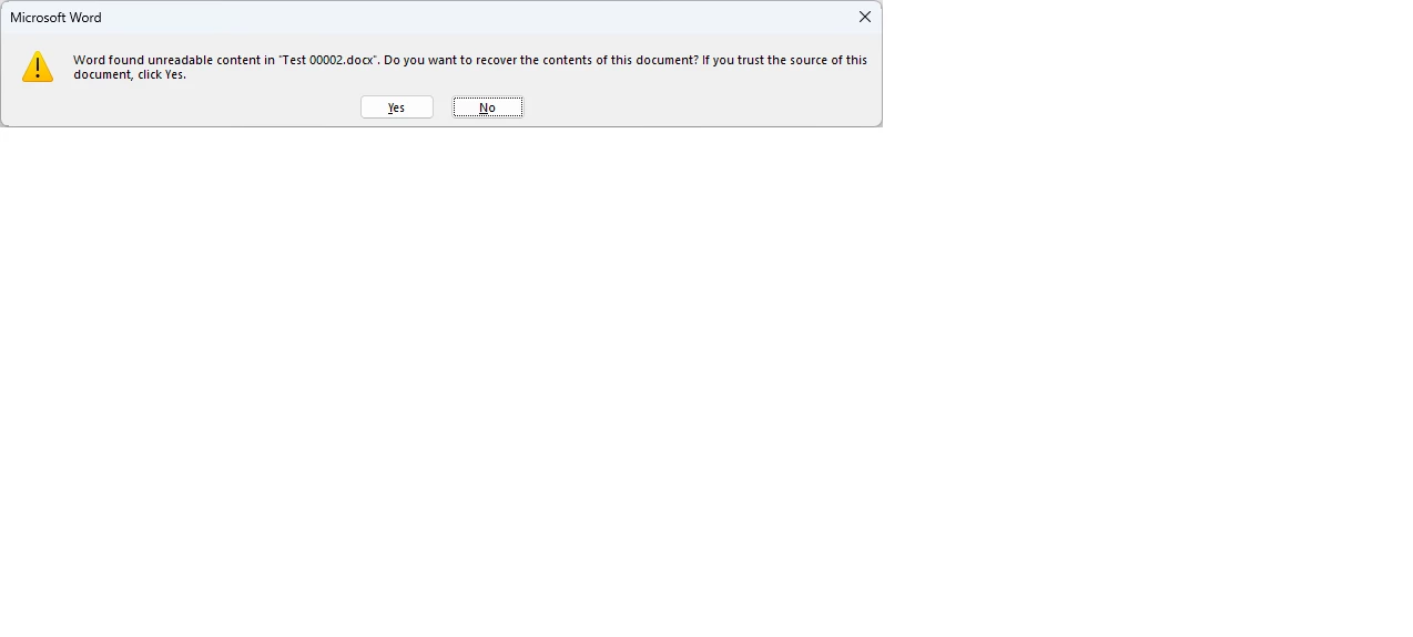

First getting below error (see error-msg1.png)
"Word found unreadable content in 'Test 0002.docx'. Do you want to recover the contents of this document? If you trust the source of this document, click Yes."

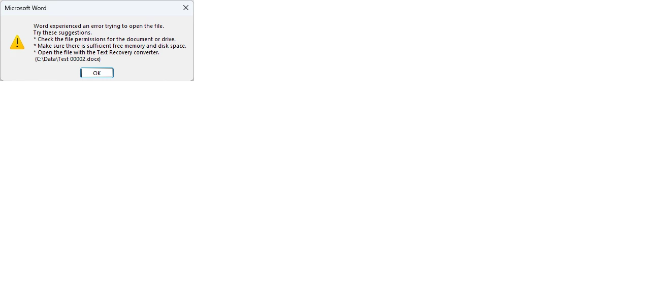

and then word is unable to recover file and getting below error (see error-msg2.png).
Word experienced an error trying to open the file.
"Try these suggestions.
*check the file permissions for the document or drive
*Make sure there is a sufficient memory and disk space
*Open the file with the Text Recovery converter."
it looks like sample code provided seems to be not working. Any suggestion?
