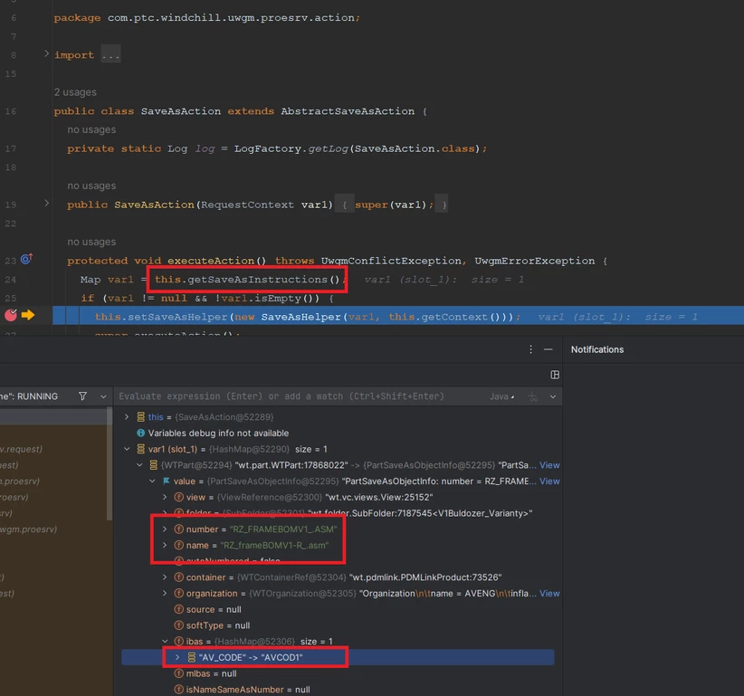

here is the place where you can find all information from the wizard with new values
it is saveAsInstructions variable that is in a com.ptc.windchill.uwgm.proesrv.action.AbstractSaveAsAction class.
You can try to create SaveAs helper and try to get instructions from this helper. But Iam not sure if this is possible to do from delegate class.
