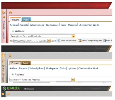

I am looking for any information on how to enable a dark mode for my in creo Windchill. Last Ive checked it is not an option and I would love it to be. I was able to make my outside browser Windchill dark.

The UI configuration does not exists.
If you want to change the color schema of the system, change all CSS styles in the system..

@JG_10788594  You can customize the css styles as suggested by @HelesicPetr , if you change correctly the text and background colors this would be a good solution.
In addition, there is a hack in modern browsers to enable dark theme, see https://www.ptc.com/en/support/article/cs371620, but looks not very promising. It was not tested on the embedded browser in Creo, only in the standalone browser.
+ In Windchill 13.0.1 a new theme has been introduced with a new font-size and colors with more accessibility features, it’s called PTC Design System. You’re going to like it, certainly !
+ Generic UI customization articles are collected in this hub https://www.ptc.com/en/support/article/CS361437, and accessibility features in https://www.ptc.com/en/support/article/CS352883.

If you are viewing Windchill in Chrome, you can use an “experimental” Chrome feature. Go to chrome://flags and enable “Auto Dark Mode for Web Contents”. For me, some of the lines look a little weird, but it works.
