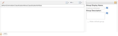

Hi All, Hi @HelesicPetr
I have a Data Utility were I process the attribute values using the gatDataValue(). But the data utility does not get called for Common Attributes(allNonSchemaNonClassificationMinusClassificationRefIbas) in a WTPart.  If the attributes are listed maybe I can assign the selector in the Layout attribute properties but for Common Attributes the attributes are not listed but I see just one cell with value "allNonSchemaNonClassificationMinusClassificationRefIbas". Can anybody help me know why?

Hi @MV_10441462
What do you mean Common Attributes?
Have you set the service,properties with DataUtility configuration?
I usually use internal name of parameter as a selector and add it to the service.properties
then the DataUtility is called almost everywhere the attribute is shown.

The Common Attributes group in the WTPart Layout. The method getDataValue() in the Data Utility is not getting called for the specified attribute in this "allNonSchemaNonClassificationMinusClassificationRefIbas". And yes I have set the configuration in xconf file still no luck. The data utility gets called for the same attribute if its added separately in the grid for a different group like General.

Hi @MV_10441462
That is common, the allNonSchemaNonClassificationMinusClassificationRefIbas is just group of non defined attributes on the WTPart.
You need to add the attribute to the WTpart type . So yes the attribute needs to be added separately.
