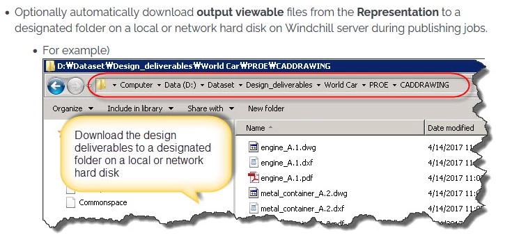

@Durga wrote:
We want the pdf drawing published by the worker to automatically dumped in Released Drawing folder.
This knowledge base article provides sample code and instructions on how to do this exact thing:
https://www.ptc.com/en/support/article/CS348848
