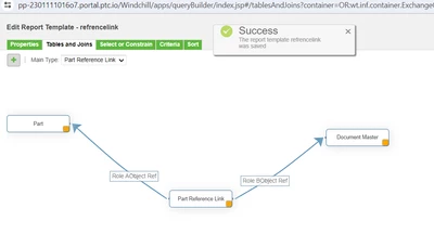

you can use , query builder to create a nice diagram :
1- dd the link object table
2- look for the classes for roleA and RoleB objects
3- add tables for class A and class B objects
4- link the tables
5- validate links
Buiꓘa

23-Emerald II
December 21, 2023
4- link the tables
5- validate links
Buiꓘa
