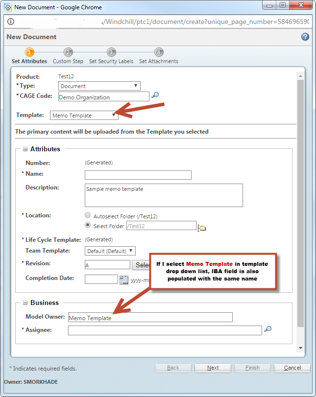

Yes, you can use JavaScript for that matter. I am not able to make it work with Name field, but I did it with IBA field. Refer below screen capture:
To do this, I have added below JavaScript function in "<WT_HOME>\codebase\netmarkets\jsp\document\create.jspf" file.
<script language="JavaScript">
  PTC.driverAttributes.on("afterRefresh",function() {
  setTimeout(function(){ getTemplateName(); }, 500);
// This function will retrieve Template value/name on Change Notice wizard
function getTemplateName() {
  // alert("test");
  var ele = document.getElementById('templatesCombo');
  var name = ele.options[ele.selectedIndex].text;
  // alert("Template name :: " + name);
  var chk = "-- Select a Template --";
  if (name == chk) {
  var elem = document.getElementById("model");
  elem.value = "";
  } else {
  elem.value = name;
</script>
I hope this helps you!
Shirish
P.S. Please note, this is just for your reference. Please test and validate this on test environment first.

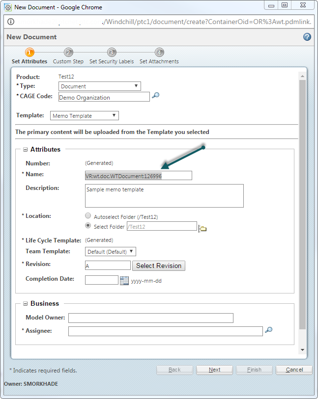

You can use jQuery to change the Name field. Using FireFox inspect element you can see there are actually 2 inputs whose id starts with "NameInputId". The difference is one is type text and the other is type hidden. The type text is the one you want to change so you could use jQuery like this:
    // alert("test");
    var name = jQuery('#templatesCombo').val();
    if(name != chk) {
        //Note there are 2 inputs like this
        //The "real" one is type=text and there is also one of type=hidden
        //this will select the one of type=text and change it
        jQuery("input[id^=NameInputId][type=text]").val(name);
ShirishMorkhade
Mar 24, 2017 5:06 PM UTC
Hi Randy Jones,
I tried this Jquery example; however it is not populating Name field with Template Name. Instead it is populated with OID (VR:wt.doc.WTDocument:XXXXX).
Shirish
dchaves-21-VisitorAuthor
May 31, 2017 2:29 PM UTC
Thank you very much for the info guys! That worked perfectly for me.
