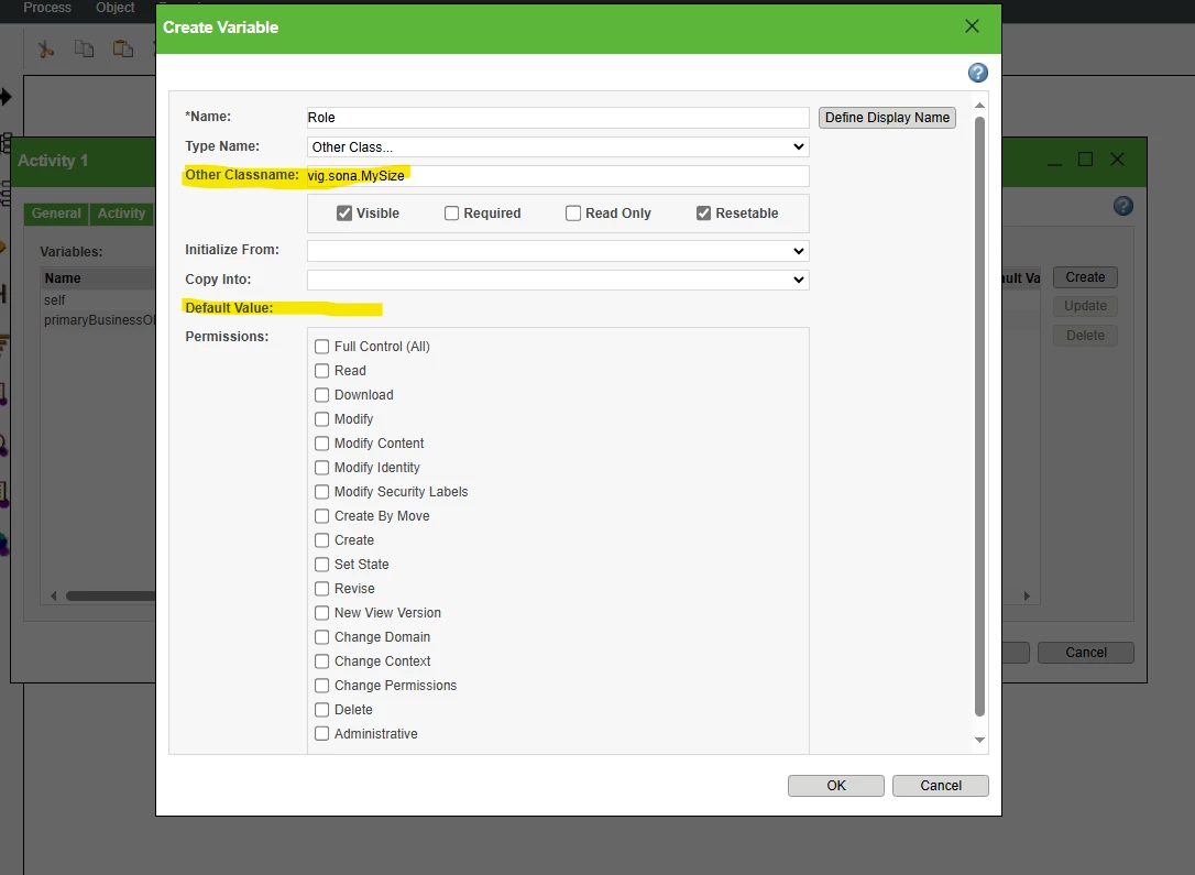

The instructions in Article CS36017 do not work as expected. Using this article as a reference, I need to address a similar issue by creating a workflow variable that utilizes my custom class as its data type. This variable should display a predefined set of roles as dropdown values, allowing it to be used as a participant in another activity.
For example, Activity 1 which has the variable "Role_of_activity_2" which user will select the role for next activity (Activity 2).

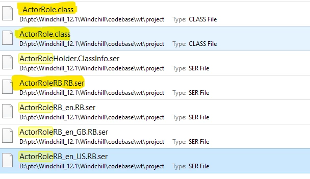

    The article I referred to explains how to create an enumerated list within the workflow activity task page. I followed all the outlined steps—successfully compiling MySize.java and the associated .rbinfo file. However, I couldn't locate the .ser file, which is typically generated after compiling the resource bundle. Consequently, the MySize.class isn't recognized on the variable creation page.
    Additionally, I aim to implement a dropdown list of roles using the same approach. My plan is to create a resource bundle similar to the existing one in Windchill, "ActorRoleRB.RB," but tailored to include the required number of roles.

    The ser file is generated after ant compilation
    • ant -f bin/tools.xml bundle_custom
    • ant -f codebase/MakeJar.xml custUpdate
    If the workflow editor can not find your class then you did not place the class to a correct place.
