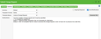

Email notifications body is empty on workflows
  • September 26, 2023
  • 7 replies
  • 2963 views
Best answer by RG_10753677
I had few variables, which were set to visible on an activity, and not visible on the other one. That caused a null value, which in-turn wiped out the entire 'body' of the html/email.

Are using a notify by email robot ?
like below
Buiꓘa
September 27, 2023
No, I am using the 'Send Notification' checkbox in activity.
