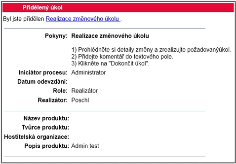

Hi @BenLoosli
Generally you can modify all workflow notifications
the files are located in  <WT_HOME>\codebase\templates\workNotification
there are HTML files with specific languages.
here is help description Workflow Email Notifications
You can modify that page and you can add any additional text to the message.
Also you can format the page for better looking
General.html files are used for assigned task messages
CZ style
PetrH
