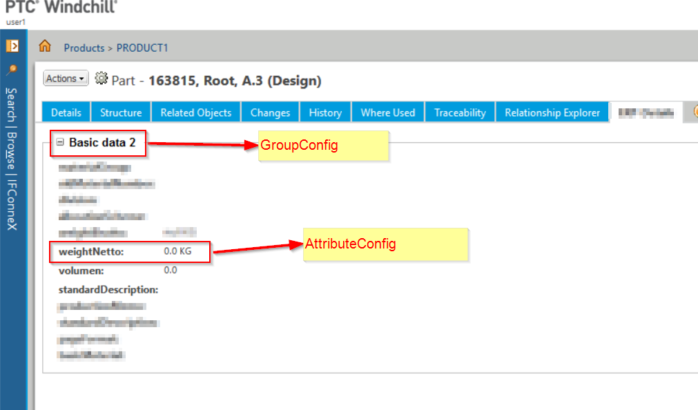

I'm trying to implement a new client view on the part info page. I am happy to know that there is a list of ComponentConfig (see e.g page 260 of PTC Windchill Customization Guide for 11.0F000). Some of them:
  • TableConfig
  • AttributesTableConfig
  • TreeConfig
  • AttributePanelConfig
Does someone know where to find a description or screenshots of the result while using each object ?
A description of the hierarchies of the component would also help me a lot : what component could be added (or not) to a component.
From the class names, I could implement a prototype with GroupConfig and AttributeConfig. Something like following :
The javadoc could not help me so much, and I cannot seriously experiment everything....
Best Regards,
Loïc

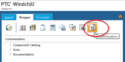

A Component catalog is available in Windchill directly for site administrator.
You'll have to set the preference "Client customization" to yes to get the "Customization" navigation Tab:
