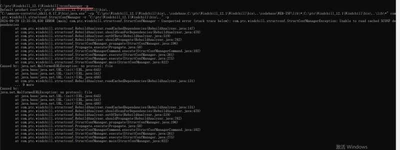

Execute xconfmanager - p error message
Version: Windchill 12.0
Use Case: I encountered an error message while executing xconfmanager - p in Windchill shell: ERROR [main] com.ptc.windchill.structconf.StructConfManager - Unexpected error (stack trace below):
Description:
The attachment contains my specific error message

Hello @ZK_11667139
You did some changes to sitexconf xml file or you did some miswrite error in some property or some target config for property does not exisst.
So you should check the syntax in the xconf's files. and correct it.
