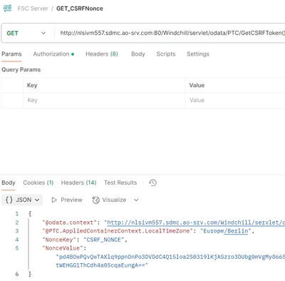

    1, Get latest CSRF NONCE
    URL: http://<server>:80/Windchill/servlet/odata/PTC/GetCSRFToken()
    Request Type: GET
    Only Authorization tab needed to be filled in Postman
    Copy the Nonce Vale

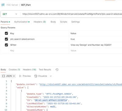

    2. Get the OID for Part
    URL: http://<server>:80/Windchill/servlet/odata/ProdMgmt/Parts?ptc.search.latestversion=true&$filter=View eq 'Design' and Number eq 'DQ001'
    Request Type: GET
    Copy the part ID

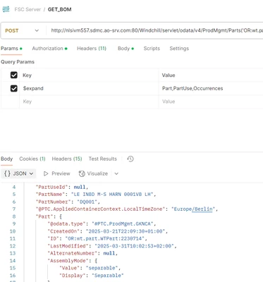

    3. Exceute the Get BOM
    URL: http://<server>:80/Windchill/servlet/odata/v4/ProdMgmt/Parts('OR:wt.part.WTPart:2230714')/PTC.ProdMgmt.GetBOM?$expand=Part,PartUse,Occurrences
    Request Type: POST
    Replace the Part ID in step 3 url as fecthed in step 2

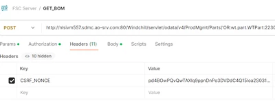

    Also, add a parameter as CSRF_NONCE with value as fetched in step 1 in the headers tab in Postman as shown below

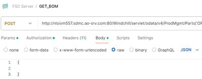

    Give the body as {} in the Body tab in Postman as shown below
    Then execute the request to get the result.

    Remove Nav criteria and keep the body blank.
