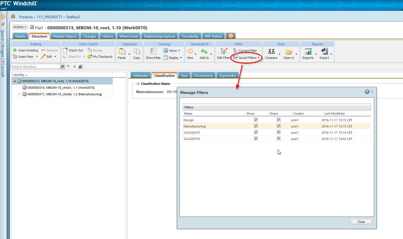

In the Windchill GUI, on the structure tab (info page of a WTPart), I can define and reuse Filter for the configuration. See the following immage:
I would like to export the part structure using one of the saved filter I created in Windchill.  My first approach is to try to find the instance of ConfigSpec, but I could not really find the way to go.
Is the following a good starting point or should I look for "Filter" instead of ConfigSpec?:
ConfigService.getConfigSpecFor(NavCriteriaContext(....))

There is a direct way of getting the Filter for WTPart structure:
NavigationCriteria navigationCriteria = NavigationCriteriaHelper.service.getNavigationCriteria("MyFilter");
I am not quite sure how to get the Filter for structure of WTDocument, it could be thsnls one of the other methods of the service.
