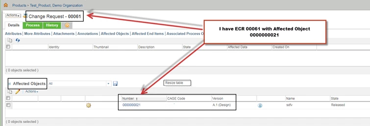

Here is an working example to retrieve AffectedObjects from Change Request:
Consider below UI for reference:
Below is my sample code:

Here is what I got as an output:
 QS :: SELECT A0.*
 FROM wt.change2.WTChangeRequest2 A0
 WHERE (WTCHGREQUESTNUMBER = '00061')
joins=null
useBind=true [00061]
 ECR Queried :: 1
ECR Numbar :: 00061
0000000021, sdfv, <object_name>, A (Design)
