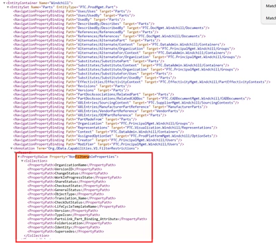

Is there any OOTB way to GET checked out objects of a subtype (for eg. WTDocument) by a specific user?
I don't want to create a custom endpoint

You can use /DocMgmt/Documents REST API to get checkout documents using $filter with CheckoutStatus field and you can get the checked out by in the feild CheckoutState in your response. you can play around with that in your code based on requirement
8-Gravel
Apr 18, 2025 4:36 AM UTC
When I apply filter to the CheckoutStatus of the CheckoutState fields, it says that these properties are Non-Filterable Properties.

These attributes are not serachable , generally its for non-persistable attributes or when it may cause performance issues :
Alternatively you can prepare a qml report or a saved search  and the call the search/report using REST
