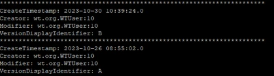

Hello ,
Thank you for the methode , but it display only 2 iteration
October 31, 2023
 this is our example

October 31, 2023
Hi @AB_9905442
And is it wrong? why? you didn't provide real data if there are just versions A.1 and B.1 the result is correct.
