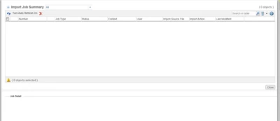

I am getting warning message(No Enumeration type exists with "update_checked_out_parts as its internal name") on Import Job Monitor Wizard and not showing any running job.
PFA.

Hi @BA_10670508
No Enumerations means that your system missing some values in an attribute update_checked_out_parts
So check an article CS328317 on the PTC Knowledge Base
PetrH
