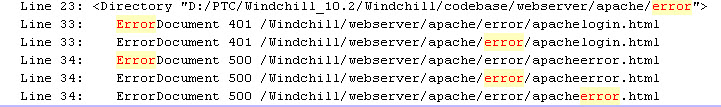

Here is where you have all the error files from Apache
