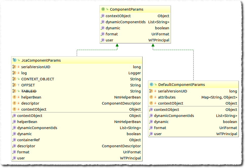

The key is to cast the ComponentParams parameter to com.ptc.jca.mvc.components.JcaComponentParams
Then you'll have access to more things, like the NmHelperBean :
Object buildComponentData(ComponentConfig componentConfig, ComponentParams componentParams) {
  JcaComponentParams jcaComponentParams = (JcaComponentParams)componentParams;
  NmCommandBean nmCommandBean = jcaComponentParams.getHelperBean().getNmCommandBean();
  // The selected items :
  ArrayList nmoids = nmCommandBean.getSelectedOidForPopup()
