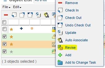

Hide OOTB Revise in Workspace UI
We need to hide/disable OOTB Revise button from Workspace table & CAD --> Right click --> Revise, Since this is WGM UI, Please suggest the approach to achieve the same in Windchill WGM 12 & Windchill --> Product --> Workspace UI.
Snapshots from Workspace UI.

Hi @MN_10518175
Unfortunately the menu in the workspace is hardcoded.
It is not supported to change it.
But if you want to do some extra not recommended steps you can check specific class that is responsible for that actions.
This is not supported and not recommended.
!If you do not know what you are doing, don't do it. !
You need to find com.ptc.windchill.uwgm.cadx.ws.WsMenuBarHelper class.
It is located in a wncWeb.jar
You need to recompile it and change it then place it to the standard wch/codebase folder structire and then remove it from wncWeb.jar ...\Windchill\codebase\WEB-INF\lib\wncWeb.jar
In this class you find a definition where the revise action is added
this.addAction(var4, "REVISEITEMSMULTI", "Toolbar_MULTIREVISE_label", var5, this.getImage(var2, "netmarkets/images/revise.gif"));
You can change the condition that action is not shown.
compile the class and place it to the correct package place in codebase/com/ptc/windchill/uwgm/cadx/ws

Hello @HelesicPetr ,
Thanks for the suggestion. I will apply this logic by commenting the specific line in code and let you know the results.
September 20, 2023
As mentioned, I've decompiled the specific java file and put it inside ws folder under src location by commenting the revise action logic, I can compile & keep the latest class file under codebase location.
One question here is, Are we need to remove that old class file in wncWeb.jar file? if so, how do we need to handle this? Any steps are there to build the latest jar?

The revise was not available to some of my users and it took me a while to figure out what it was. The original system implementor had set up policies that hid the revise function for certain users. Once I removed the policy from that group of users, they had the revise button.
September 19, 2023
Hello @BenLoosli ,
I believe that you approach is to apply policy under Site/Org/Product level which will hide or disable the revise action throughout Windchill.
Our requirement is to hide the revise action from right click & revise button from Workspace. I am looking for way to customize the actions
