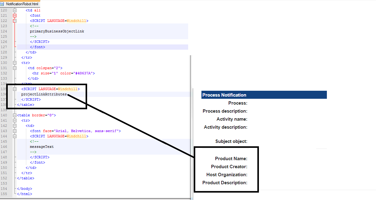

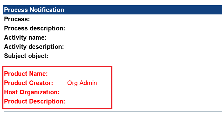

I want to change Process Notification template. I attached a screen shot and I want to remove in the red box area. How can I change template ?
I think I have to change NotificationRobot.html but I have no idea where to change.

Do a search in WHC for "Workflow Email Notifications".  You'll want to create a new HTML file in <Windchill>\codebase\templates\workNotification\.
Is this helpful?
January 11, 2017
My Hunch is you will have to remove "projectLinkAttributes" section from the process notification html which you are referring. For example for the CN completion remove the mentioned section from the "NotificationRobot.html" or create new html without this section and use that.
