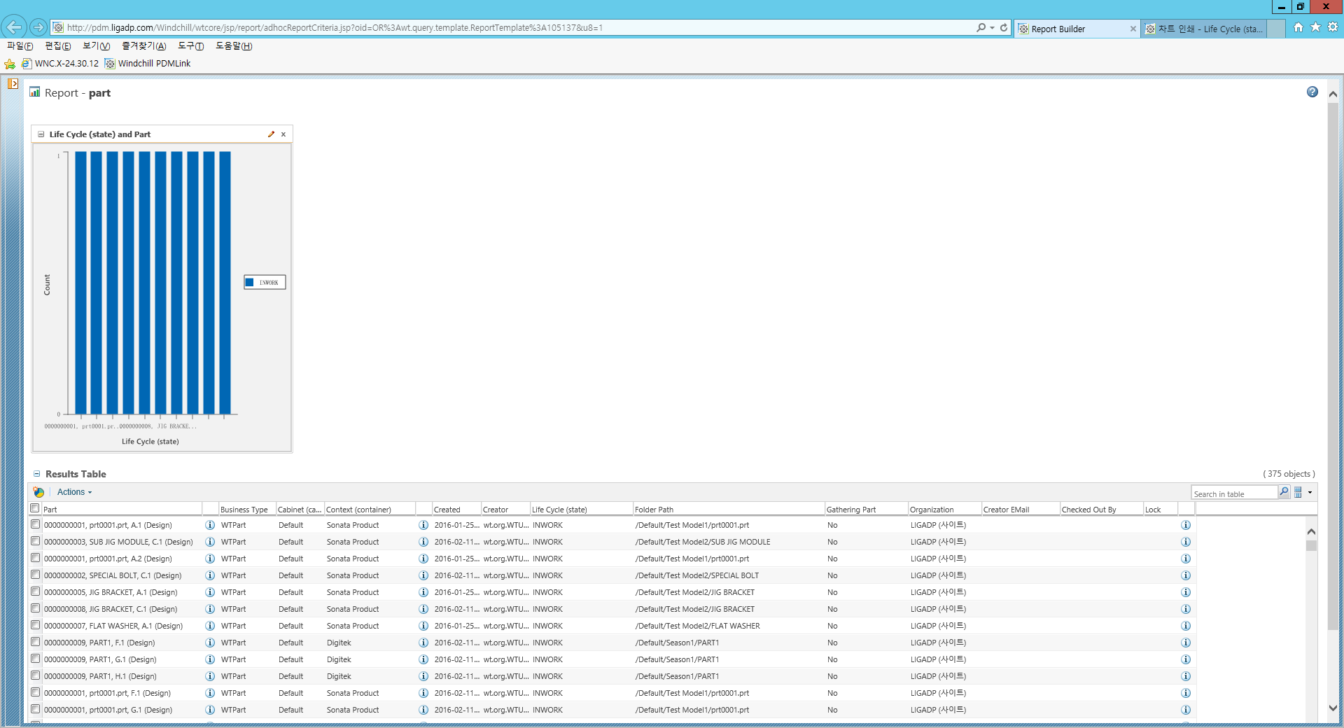

April 27, 2016
I recommend to use Report Management utility (location: [site] > [utility] > [Report Management])
For your reference, I attached sql file (i.e., part.qml).  I hope that you could make a report for part.
Please, let me know if you have any question.
