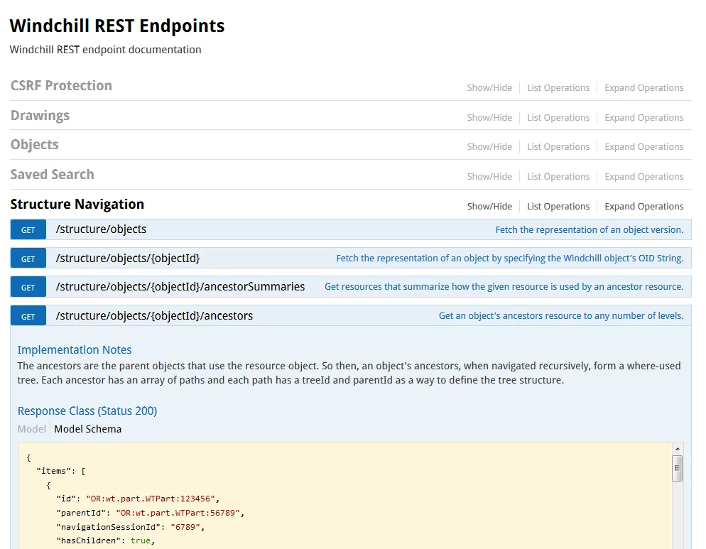

The list of operation is listed under https://YOURWINDCHILLURI/Windchill/netmarkets/jsp/restapi/index.html and depend of Windchill version but in 11 M10, i have this kind of function:

I using Windchill 11.0 M030 , and I already tried "GET /structure/objects/{objectId}/ancestors" .
But I got specific object's ancestors. I want to get Windchill existing type hierarchies as definition information.
