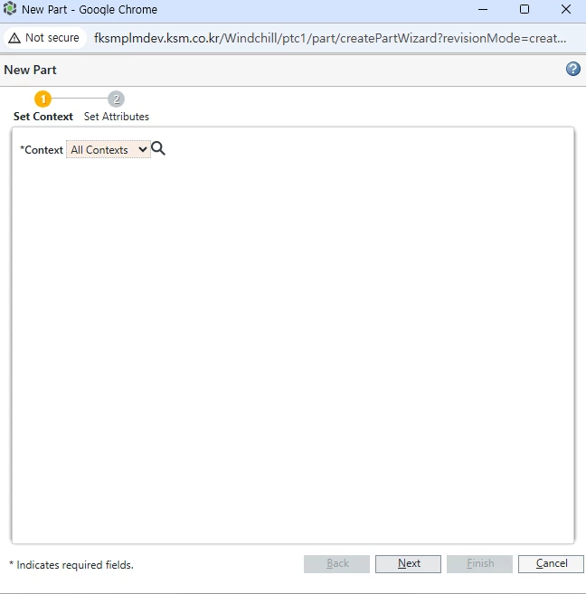

How can I launch the create wizard for a WTPart soft type without the context step?
I need to create a create wizard for soft type WTParts, but I want to skip the context selection step (by pre-selecting it) and start directly from the subsequent screen.
However, no matter how I configure `custom-actions.xml`, I can't figure it out.
Could you tell me how to solve this?
need to skip
I would like the pop-up window to launch immediately at that stage.

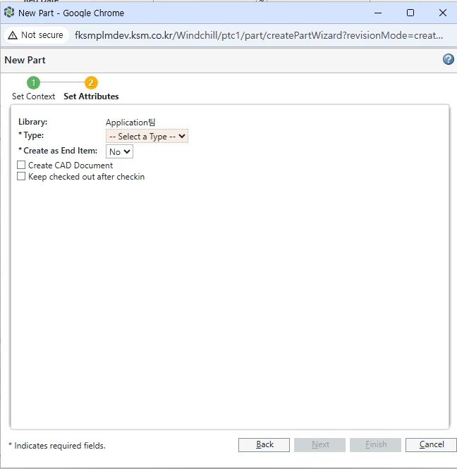

you have to specify the OID of folder in URL %24&oid=OR%3Awt.folder.Cabinet%3A8827238

it works! thanks a lot
