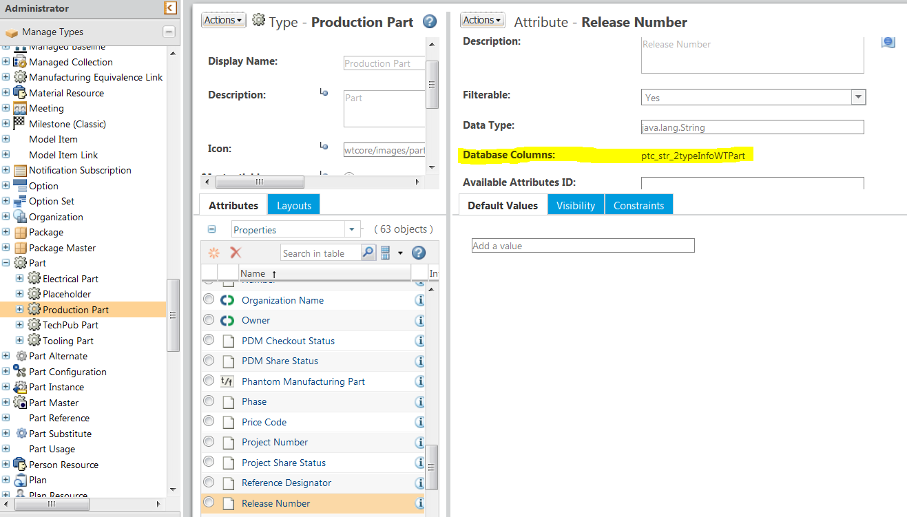

I am wanting to programatically find the database column(s) associated with a custom standard attribute. This would be the columns created by using the AddColumns utility and then are used when creating a custom standard attribute. The Type and Attribute Manager shows it as shown in the screenshot. How does it find it?
So starting with a given subtype and a given standard parameter internal name how would I find this same information that the Type and Attribute Manager is showing?

The column value you are looking for is LWCColumnAllocation.PHYSICALNAME
Note that the value of this column is stored as typeInfoWTPart.ptc_str_1
LWCColumnAllocation is a table that links the type to the attribute.
  • LWCColumnAllocation.IDA3A3 = LWCFlexAttDefinition.IDA2A2
  • LWCColumnAllocation.IDA3B3 = <object type's IDA2A2 (LWCTypeDefinition.IDA2A2)>
Below are both SQL and Java code to return PHYSICALNAME
SQL
select ca.physicalname from lwccolumnallocation ca, lwctypedefinition tdef, lwcflexattdefinition attdef
where ca.ida3a3 = attdef.ida2a2
and ca.ida3b3 = tdef.ida2a2
and tdef.ida2a2 = 144505
and attdef.name = 'CustomString1';
where lwcflexattdefinition.name is the attribute internal name
