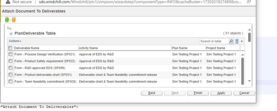

how disable cancel button in wizard
Is there a way to disable cancel button at last page of wizard, Below SS is last page of wizard and I want to disable the cancel button.

Article - "Suggested techniques to disable Wizard buttons using Windchill API": https://www.ptc.com/en/support/article/CS237700

@SB_10904295
The @VladimirN solution provided by article works.
