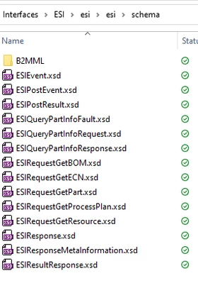

We navigated to WT_HOME\codebase\com\ptc\windchill\esi\schema and did not find the cbo XSD. We can see B2MML. Here is the snapshot:
Should there be a separate schema from OOTB for CBO ? Can you post a copy of the CBO schema ? Release: 12.0.2.0

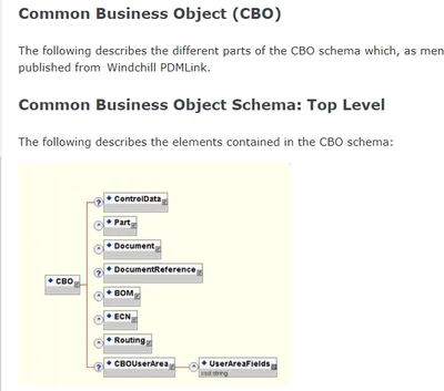

Common Business Objects are Parts, CAD, Change Notices and Documents etc, there is no cbo.xsd
